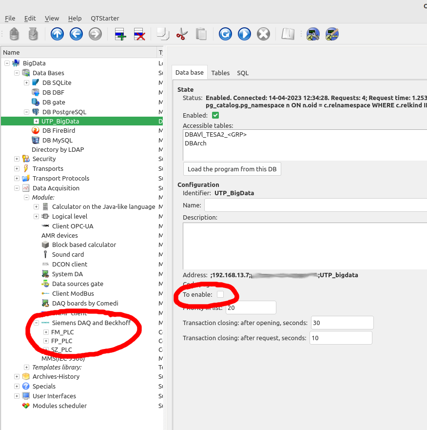

If I have two different database (SQLite and PostgreSQL), openSCADA can't load Data Acquisition's config properly if all databases "To enable".

Templates library loads - OK. I can't load Siemens DAQ and Beckhoff

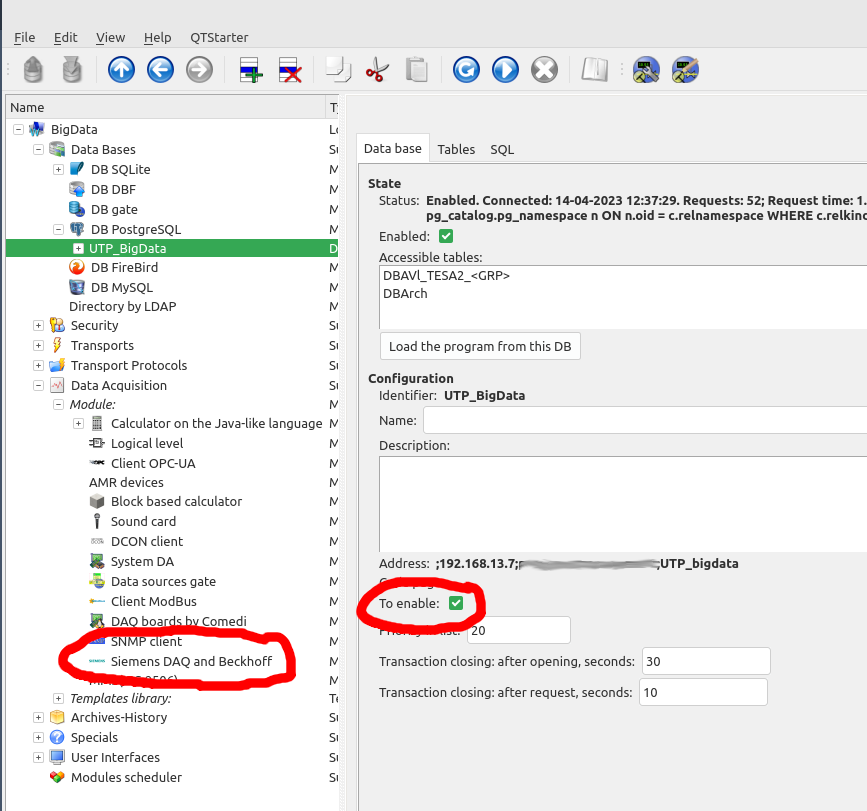

Please see demo video
bug demo

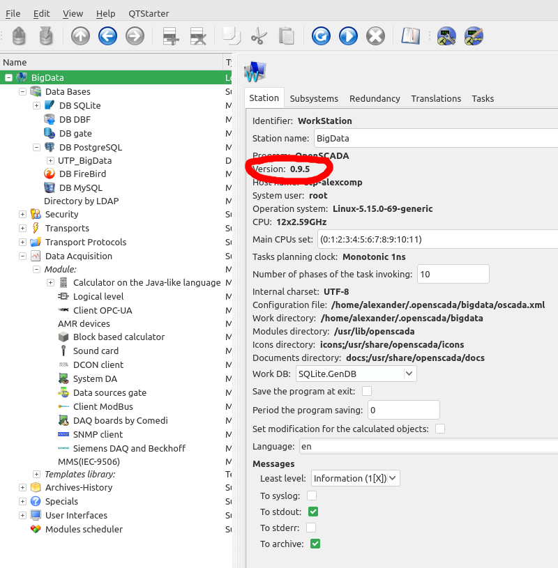

Previous (0.9.4, 0.9.3...) versions work perfectly. This problem is only with new versions 0.9.5, 0.9.6. I tried the AGLKS configuration and got the same problems.
Thanks for your work.
