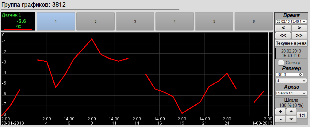

График "рвется" с периодичностью ротации архива (смотри рисунок).

Смотрю через соответствующий архив значений:
Thu Jan 10 02:00:00 2013	0	-nan
Fri Jan 11 02:00:00 2013	0	-11.0613419105356
Sat Jan 12 02:00:00 2013	0	-8.09974593756001
Sun Jan 13 02:00:00 2013	0	-8.09954718514705
Mon Jan 14 02:00:00 2013	0	-9.04183217002108
Tue Jan 15 02:00:00 2013	0	-9.04183217002108
Wed Jan 16 02:00:00 2013	0	-9.04183217002108
Thu Jan 17 02:00:00 2013	0	-9.04183217002108
Fri Jan 18 02:00:00 2013	0	-8.67055160513323
Sat Jan 19 02:00:00 2013	0	-4.14263649015417
Sun Jan 20 02:00:00 2013	0	-3.30894618703767
Mon Jan 21 02:00:00 2013	0	-4.94531353027045
Mon Jan 21 02:00:00 2013	1	<EVAL>
Tue Jan 22 02:00:00 2013	0	-3.89882817628896
Wed Jan 23 02:00:00 2013	0	-5.84340964139441
Thu Jan 24 02:00:00 2013	0	-7.22000388339844
Fri Jan 25 02:00:00 2013	0	-7.45035571640593
Sat Jan 26 02:00:00 2013	0	-7.45035571640593
Sun Jan 27 02:00:00 2013	0	-7.8937758339377
Mon Jan 28 02:00:00 2013	0	-10.6593889120163
Tue Jan 29 02:00:00 2013	0	-9.01472536252232
Wed Jan 30 02:00:00 2013	0	-7.95162403586512
Thu Jan 31 02:00:00 2013	0	-6.95520553354439
Fri Feb  1 02:00:00 2013	0	-5.47622479108792
Sat Feb  2 02:00:00 2013	0	-3.99326626694019
Sat Feb  2 02:00:00 2013	1	<EVAL>
Sun Feb  3 02:00:00 2013	0	-2.61389070784391
Mon Feb  4 02:00:00 2013	0	-2.74550504568774
Tue Feb  5 02:00:00 2013	0	-5.22802610286357
Wed Feb  6 02:00:00 2013	0	-4.04985910297557
Thu Feb  7 02:00:00 2013	0	-2.52096765458643
Fri Feb  8 02:00:00 2013	0	-1.58138744278234
Sat Feb  9 02:00:00 2013	0	-0.589523972924572
Sun Feb 10 02:00:00 2013	0	-2.05553212753533
Mon Feb 11 02:00:00 2013	0	-2.50144289163069
Tue Feb 12 02:00:00 2013	0	-2.71802521083265
Wed Feb 13 02:00:00 2013	0	-2.45396445995563
Thu Feb 14 02:00:00 2013	0	-3.06271849378598
Thu Feb 14 02:00:00 2013	1	<EVAL>
Fri Feb 15 02:00:00 2013	0	-3.98205873419988
Sat Feb 16 02:00:00 2013	0	-5.38909624562249
Sun Feb 17 02:00:00 2013	0	-5.6703021637906
Mon Feb 18 02:00:00 2013	0	-6.12113617617705
Tue Feb 19 02:00:00 2013	0	-7.71285104203043
Wed Feb 20 02:00:00 2013	0	-7.16218795787323
Thu Feb 21 02:00:00 2013	0	-6.65209426793822
Fri Feb 22 02:00:00 2013	0	-5.16398128360655
Sat Feb 23 02:00:00 2013	0	-4.66488803468369
Sun Feb 24 02:00:00 2013	0	-3.89590206033206
Mon Feb 25 02:00:00 2013	0	-5.37439173185114
Tue Feb 26 02:00:00 2013	0	-5.04422091224539
Tue Feb 26 02:00:00 2013	1	<EVAL>
Wed Feb 27 02:00:00 2013	0	-6.6507238240193
Thu Feb 28 02:00:00 2013	0	-5.63566322646991
На границе архивных файлов, со смещением 1мкс относительно предідущего валидного значения пишется <EVAL>. По видимому он, то и "рвет" график. (см. рисунок)
Используемая версия скады 0.8.0.4+svn1960.
По видимому связано с способом формирования нового архивного файла http://wiki.oscada.org/Doc/FSArch?v=kqp#h86-7
При создании нового файла архива формируется: заголовок (структура заголовка в таблице 1), нулевая битовая таблица упаковки архива и первое недостоверное значение. Таким образом, получится архив, инициализированный недостоверными значениями.
Как посоветуете обойти данную проблему, и добиться непрерывного графика?

Written on: 28. 02. 2013 [16:14]
Никогда у меня такого не было и нет, если хотите — можете поглядеть здесь: http://oscada.org:10002/WebVision/ses_AGLKS/
Правда часовой там только для "Pi", однако включил для всех на первой группе графиков.
Понаблюдайте, он там уже год работает без каких либо проблем в архивах.
"aleax" wrote:
т.е. ротация происходила 2013-01-10, 2013-01-22, 2013-02-03, 2013-02-15 и 2013-02-27
Нормально — 288 часов
[js]
Вы вообще как в архив значения записываете? Нужно через буфер.
Кем пишется?
"aleax" wrote:
По видимому связано с способом формирования нового архивного файла http://wiki.oscada.org/Doc/FSArch#h86-7
Не связано ибо запись нормального значения смещает затем EVAL.
У меня такого нет нигде. Возможно конечно потому-что я не пишу значения прямо в архив минуя буфер. В любом случае я этого не поймаю, поэтому ставьте дампы печати при записи в архив, на время создания нового файла, и смотрите почему туда значение не пишется.
