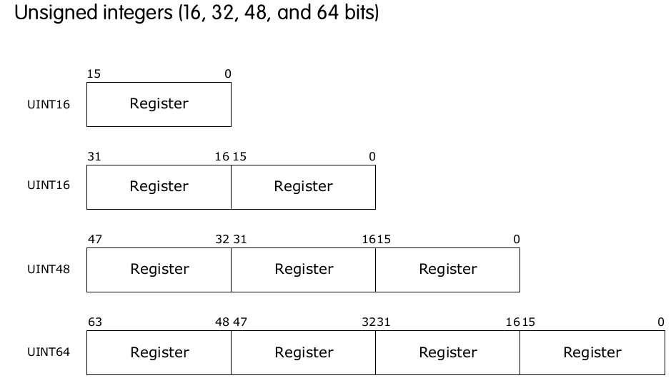

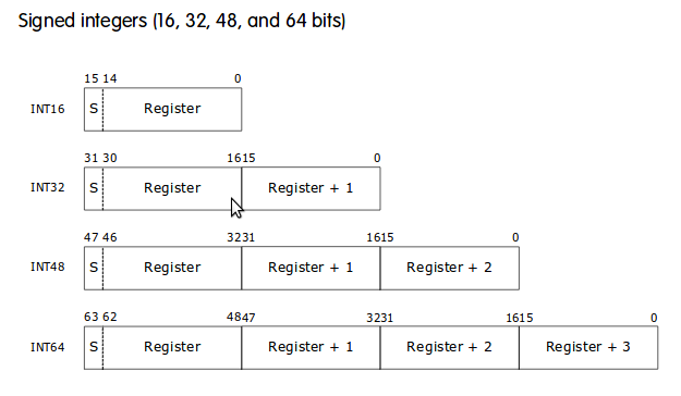

s60ru
Антон Петров
registered since: 10.05.2012
Posts: 141

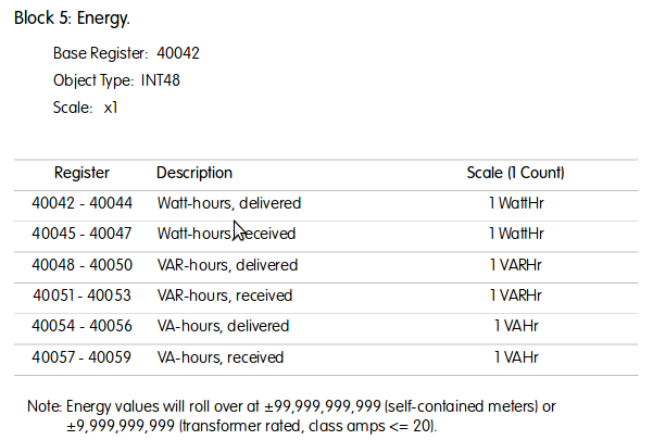

https://habrastorage.org/web/acf/29b/b45/acf29bb458c046779ba02c54b4176fc4.png
https://habrastorage.org/web/f65/834/a96/f65834a963a242f9a534ff2c78bce846.png
Register ----------- Description ----------- Scale (1 Count)
40042 - 40044 --- Watt-hours, delivered --- 1 WattHr
40045 - 40047 --- Watt-hours, received --- 1 WattHr
40048 - 40050 --- VAR-hours, delivered --- 1 VARHr
40051 - 40053 --- VAR-hours, received --- 1 VARHr
40054 - 40056 --- VA-hours, delivered --- 1 VAHr
40057 - 40059 --- VA-hours, received --- 1 VAHr

Written on: 20. 05. 2017 [00:14]
s60ru
Антон Петров
Posts: 141
https://habrastorage.org/web/939/b19/223/939b1922386f4bc7950977c53afffdb5.png
