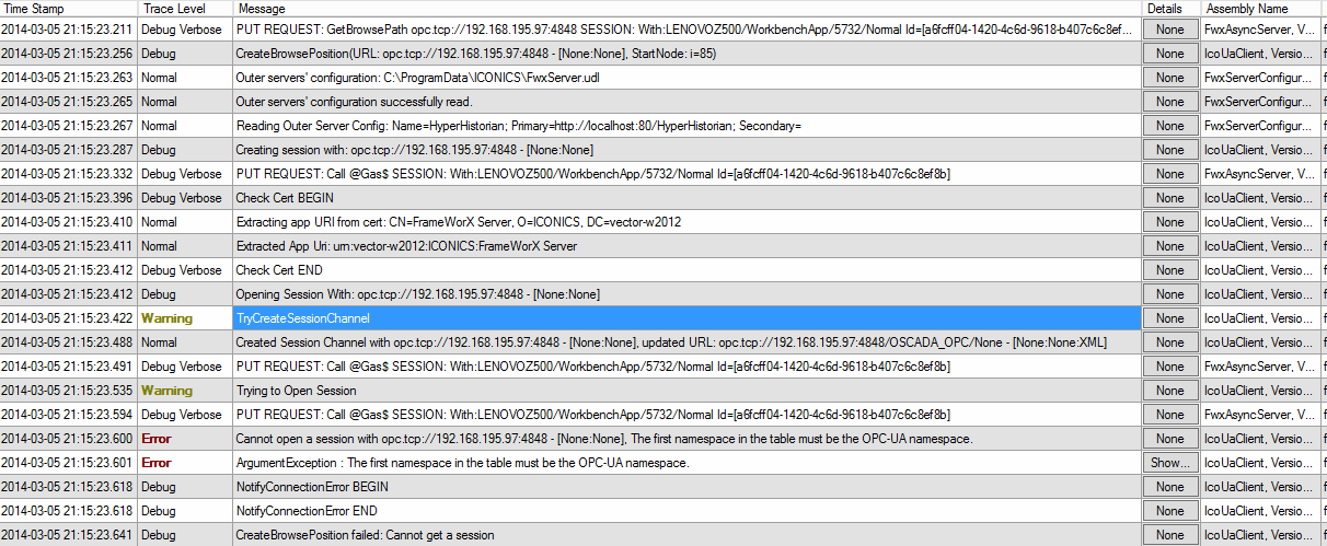

Нашел в логах Genesis64 ошибку
HTML
<record level="800" timestamp="2014-03-05T16:52:54.859" processID="6532" threadID="86" file="Unknown" lineNo="0" SeqNo="919666" colNo="0" processName="C:\Program Files\ICONICS\GENESIS64\Components\IcoFwxServer.exe" threadName="Session Worker: opc.tcp://192.168.195.97:4848 - [None:None]" appDomainID="50081034" appDomainName="IcoFwxServer.exe" assemblyName="IcoUaClient, Version=10.80.118.0, Culture=neutral, PublicKeyToken=58aa7495915e8ed4" assemblyCodebase="file:///c:/program files/ICONICS/genesis64/components/IcoUaClient.DLL" namespace="Ico.Fwx.Ua.Client" class="UaClientSession" method="a(String A_0, PasswordCache A_1, Boolean A_2, String&amp; A_3)">
  <message>Cannot open a session with opc.tcp://192.168.195.97:4848 - [None:None], The first namespace in the table must be the OPC-UA namespace.</message>
</record>
<record level="800" timestamp="2014-03-05T16:52:54.860" processID="6532" threadID="86" file="Unknown" lineNo="0" SeqNo="920493" colNo="0" processName="C:\Program Files\ICONICS\GENESIS64\Components\IcoFwxServer.exe" threadName="Session Worker: opc.tcp://192.168.195.97:4848 - [None:None]" appDomainID="50081034" appDomainName="IcoFwxServer.exe" assemblyName="IcoUaClient, Version=10.80.118.0, Culture=neutral, PublicKeyToken=58aa7495915e8ed4" assemblyCodebase="file:///c:/program files/ICONICS/genesis64/components/IcoUaClient.DLL" namespace="Ico.Fwx.Ua.Client" class="UaClientSession" method="a(String A_0, PasswordCache A_1, Boolean A_2, String&amp; A_3)">
  <message>ArgumentException : The first namespace in the table must be the OPC-UA namespace.</message>
  <details>
    <exceptionStackTrace>System.ArgumentException
   в Opc.Ua.NamespaceTable.Update(IEnumerable`1 namespaceUris)
   в Opc.Ua.Client.Session.FetchNamespaceTables()
   в Opc.Ua.Client.Session.Open(String sessionName, UInt32 sessionTimeout, IUserIdentity identity, IList`1 preferredLocales)
   в Ico.Fwx.Ua.Client.UaClientSession.a(String A_0, PasswordCache A_1, Boolean A_2, String&amp; A_3)
</exceptionStackTrace>
    <stackTrace>   в Ico.Fwx.Ua.Client.UaClientSession.a(String A_0, PasswordCache A_1, Boolean A_2, String&amp; A_3)
   в Ico.Fwx.Ua.Client.UaClientSession.a(String A_0, PasswordCache A_1)
   в Ico.Fwx.Ua.Client.UaClientSession.f(String serverUrl)
   в Ico.Fwx.Ua.Client.UaClientSession.d(Object A_0)
   в System.Threading.ExecutionContext.RunInternal(ExecutionContext executionContext, ContextCallback callback, Object state, Boolean preserveSyncCtx)
   в System.Threading.ExecutionContext.Run(ExecutionContext executionContext, ContextCallback callback, Object state, Boolean preserveSyncCtx)
   в System.Threading.ExecutionContext.Run(ExecutionContext executionContext, ContextCallback callback, Object state)
   в System.Threading.ThreadHelper.ThreadStart(Object obj)
</stackTrace>
  </details>
</record>
И о чём это говорит, разве только о проблемах с таблицей NS у клиента.
А таблицу NS клиент строит не получая ли ее от сервера ? Почему с другими серверами нет проблемы с таблицей NS ? Может как раз потому, что у других серверов эти NS присутствуют и в нужном синтаксисе и содержании ?
Добавил скриншот полного лога как появляется ошибка и весь лог.
IcoFwxServer2063.exe.log.xml.zip (File type: application/x-zip-compressed, Size: 13.01 kilobytes) — 738 downloads
