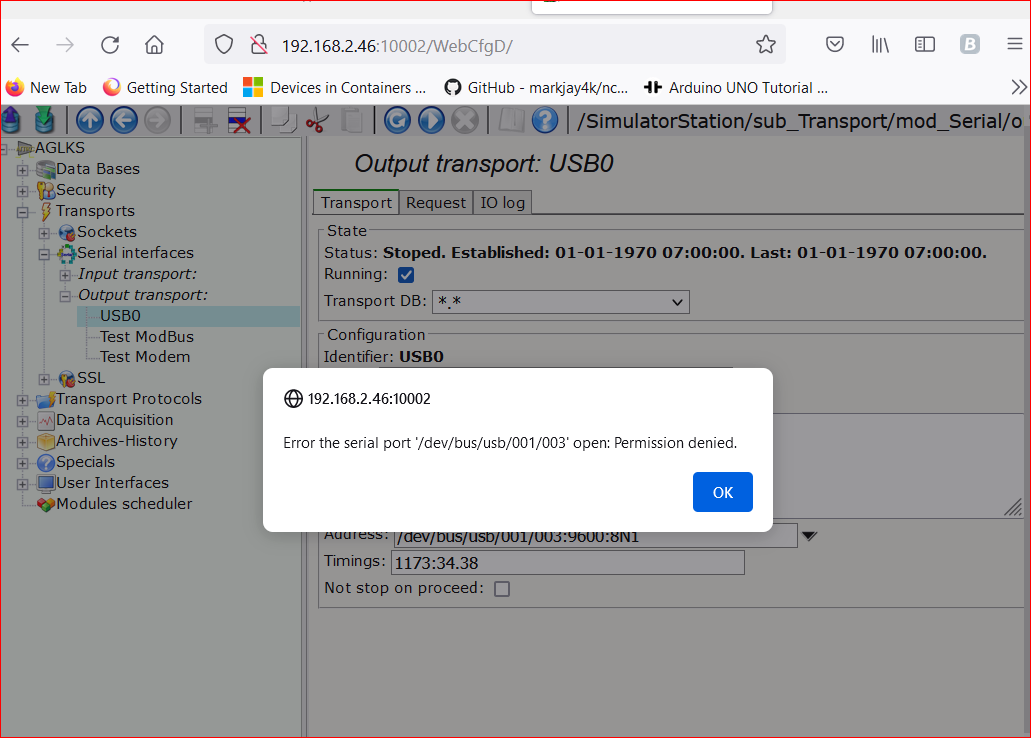

I try to use OpenSCADA on Android TV-Box with Arduino-Uno modbus RTU and others USB2Serial RTU.
I can't connect to /dev/tty* , I got error "Error the serial port '/dev/bus/usb/001/003' open: Permission denied."
I try to change many usb2serial devices, The Errors are same.
How to fix. please
Thank You

"jaranb" wrote:
I am new here,
That is not about OpenSCADA development and OpenSCADA in whole!
That is about missing such devices' drivers-modules in the Linux kernel on Android and the device path "/dev/bus/usb/001/003" is wrong!
So, search such Android packages.
