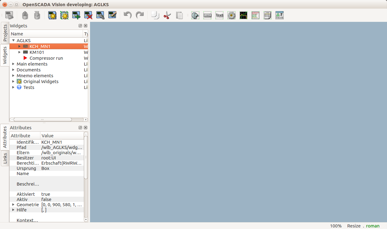

Hi,
I worked through your Quick start.
I have a problem after opening the window of development of the user interface (Chap.3.1), it looks like the enclosed picture, with no graphical elements.
When I start up execution I can see all the elemnts and it works fine, but not in the developing window.
I tried with two different PCs (Ubuntu 16.04 and Ubuntu 18.04).
Do you have any ideas?
Best regards
Martin
Bildschirmfoto vom 2019-11-03 21-12-43.png (File type: image/png, Size: 112.82 kilobytes) — 2613 downloads
Written on: 04. 11. 2019 [07:02]
There is no problem on this screen, may be you need to open for edit this frame-widget for get it in the main field of the opened frames, of Figure 3.1.3?
Written on: 04. 11. 2019 [19:18]
marty73
Martin Oswald
registered since: 03.11.2019
Posts: 2
now i've got it.
No double-click on the widget, but "edit visual item" from the context menu.
Thx for your help
